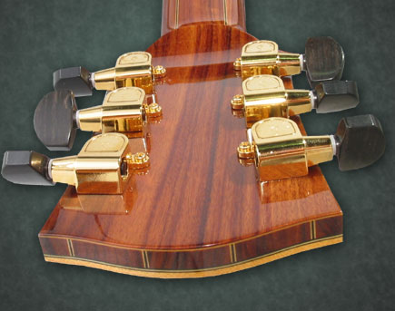

I'm looking for something to get thin black striping into my neck when I laminate it. Can the large 6" x 36" fiber veneer sheets (the particular one I saw was from LMI) be used as a neck laminate? Is it strong enough to keep from separating?
I haven't seen ebonized maple that large, so this looked like my best bet if it would hold up on the neck.
Also, does it matter what glue is used...(regular titebond or poly)?
-j.j.Brown38982.3847569444
-jack handy

Check out John Watkins' site. He has a material called "fish paper" that he uses for neck laminates.
PostPosted: Fri Sep 22, 2006 12:37 am
Get with John Watkins he got just what your looking for.
JJ, you bet me to it MichaelP38982.4014351852

Pretty much every archtop builder on the face of the earth (providing they use the dual black line look) uses two black lines of valconized fiber between their maple lams. If it's good enough for Bennedetto, it should be good.

The stuff on my site is vulcanized fiber, also known as fish paper. It's the same thing that the archtop builders, including BB, have been using in their necks for who knows how long. I've never had a problem with it, despite sometimes using quite a lot in a single neck.
John Watkins

They're 6" x 36". Let me know if you need a different size.

Thanks, John. What is best to laminate those with? Titebond, Poly, other?

I've only used titebond and CA. Both work well.

BTW: John - sharp looking neck!Anthony Z38982.9220138889
